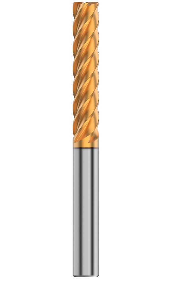

KOR5™ DS • Radiused • 5 Flutes • 5 x D • Plain Shank • Inch
KOR5™ DS Solid Carbide End Mill for Dynamic Milling of Steel and Stainless Steel
Ürün Numarası100159664
Özellikler ve avantajlar
- Designed for trochoidal milling with low radial engagement and full length of cut.
- With chip deformers for ideal chip evacuation at high surface quality.
- Proprietary flute form reduces vibrations and improves tool life.
- Helix angle tailored to minimize vibration and optimize tool life.
- Front end geometry designed for maximum tool life in helical and ramping operations.
Trochoidal Milling
Ramping: 5°
Tool Dimensions: Flute Configuration: 5
Shank - Cylindrical Plain
Helix Angle: 40°
Corner Style: Corner Radius
KOR5™ DS • 5 Flutes • 5 x D • Adjustment factor table for feed calculation • Inch
