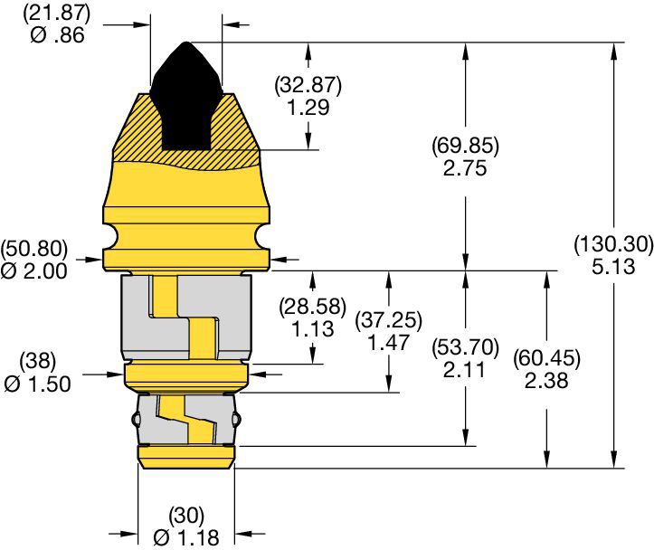

      DS105DR-X
      38/30mm Step Shank Conicals
      Metrik
      İnç
      SAP Material Number 5598260
      ISO Catalog Number DS105DR X
      ANSI Catalog Number DS105DR X
      Grade K3560
      [L1] Gage Length 69.935 mm
      [L1] Gage Length 2.753 in
      [LS] Shank Length 60.452 mm
      [LS] Shank Length 2.380 in
      [LRO] Retainer Offset Length 28.575 mm
      [LRO] Retainer Offset Length 1.125 in
      [TL] Tip Length 32.868 mm
      [TL] Tip Length 1.294 in
      [TD] Tip Diameter 21.869 mm
      [TD] Tip Diameter .8610 in
      [TDS] Tip Diameter Start 28.854 mm
      [TDS] Tip Diameter Start 1.136 in
      [D] Shank/Bore Diameter 37.719 mm
      [D] Shank/Bore Diameter 1.485 in
      [D2] Body Diameter Workpiece Side 50.800 mm
      [D2] Body Diameter Workpiece Side 2.000 in
      [DR] Shank Diameter Reduced 29.515 mm
      [DR] Shank Diameter Reduced 1.162 in
      [OAL] Overall Length 130.387 mm
      [OAL] Overall Length 5.133 in
      Cutting Condition SEVERE
      EW_MACHINE_POWER MEDIUM TO HIGH
      EW_CON_RETAINER_STYLE FRICTION POSITIVE LOCK
      Tüm Ürün Değişkenlerini görün
