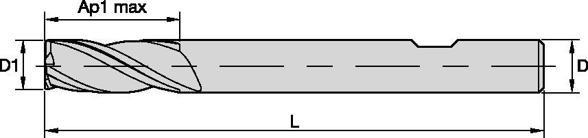

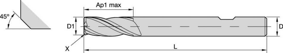

3SE..IS-IR-IL-IX • 3 Flute • Inch
Filter By:
Product # ISO Catalog Number ANSI Catalog Number Grade Adapter Style Machine Side First Choice NA First Choice EMEA First Choice AP [D1]Effective Cutting Dia Frac [D]Adapter/Shank/Bore Dia Frac [AP1MAX]1st Max Cut Depth Frac [L] Overall Length Fraction
6143903 3SE0031IR007A 3SE0031IR007A KC633M Straight-Cylindrical Y N N 1/32 1/8 5/64 1 1/2
6143904 3SE0047IR011A 3SE0047IR011A KC633M Straight-Cylindrical Y N N 3/64 1/8 7/64 1 1/2
6143905 3SE0062IR019A 3SE0062IR019A KC633M Straight-Cylindrical Y N N 1/16 1/8 3/16 1 1/2
6143906 3SE0078IR011A 3SE0078IR011A KC633M Straight-Cylindrical N N N 5/64 1/8 7/64 1 1/2
6143907 3SE0094IR037A 3SE0094IR037A KC633M Straight-Cylindrical Y N N 3/32 1/8 3/8 1 1/2
6143908 3SE0109IR037A 3SE0109IR037A KC633M Straight-Cylindrical Y N N 7/64 1/8 3/8 1 1/2
6143909 3SE0125IR025A 3SE0125IR025A KC633M Straight-Cylindrical Y N N 1/8 1/8 1/4 1 1/2
6143910 3SE0125IL050A 3SE0125IL050A KC633M Straight-Cylindrical Y N N 1/8 1/8 1/2 2 1/2
6143941 3SE0125IX062A 3SE0125IX062A KC633M Straight-Cylindrical N N N 1/8 1/8 5/8 3
6143943 3SE0156IR056A 3SE0156IR056A KC633M Straight-Cylindrical Y N N 5/32 3/16 9/16 2
6143944 3SE0188IS031A 3SE0188IS031A KC633M Straight-Cylindrical N N N 3/16 3/16 5/16 2
6143945 3SE0188IR056A 3SE0188IR056A KC633M Straight-Cylindrical Y N N 3/16 3/16 9/16 2
6143946 3SE0188IL062A 3SE0188IL062A KC633M Straight-Cylindrical Y N N 3/16 3/16 5/8 3
6143947 3SE0188IX100A 3SE0188IX100A KC633M Straight-Cylindrical N N N 3/16 3/16 1 4
6143949 3SE0219IR062A 3SE0219IR062A KC633M Straight-Cylindrical Y N N 7/32 1/4 5/8 2 1/2
6143950 3SE0219IL075A 3SE0219IL075A KC633M Straight-Cylindrical N N N 7/32 1/4 3/4 2 1/2
6143951 3SE0250IS050A 3SE0250IS050A KC633M Straight-Cylindrical Y N N 1/4 1/4 1/2 2
6143952 3SE0250IR075A 3SE0250IR075A KC633M Straight-Cylindrical Y N N 1/4 1/4 3/4 2 1/2
6143953 3SE0250IL100A 3SE0250IL100A KC633M Straight-Cylindrical Y N N 1/4 1/4 1 3
6143954 3SE0250IX150A 3SE0250IX150A KC633M Straight-Cylindrical N N N 1/4 1/4 1 1/2 4
6143955 3SE0281IR075A 3SE0281IR075A KC633M Straight-Cylindrical N N N 9/32 5/16 3/4 2 1/2
6143956 3SE0281IL081A 3SE0281IL081A KC633M Straight-Cylindrical N N N 9/32 5/16 13/16 2 1/2
6143957 3SE0312IR050A 3SE0312IR050A KC633M Straight-Cylindrical Y N N 5/16 5/16 1/2 2
6143958 3SE0312IL081A 3SE0312IL081A KC633M Straight-Cylindrical Y N N 5/16 5/16 13/16 2 1/2
6143962 3SE0375IS050A 3SE0375IS050A KC633M Straight-Cylindrical Y N N 3/8 3/8 1/2 2
6143963 3SE0375IR088A 3SE0375IR088A KC633M Straight-Cylindrical Y N N 3/8 3/8 7/8 2 1/2
6143964 3SE0375IL100A 3SE0375IL100A KC633M Straight-Cylindrical Y N N 3/8 3/8 1 2 1/2
6143965 3SE0375IX112A 3SE0375IX112A KC633M Straight-Cylindrical N N N 3/8 3/8 1 1/8 3
6143967 3SE0437IR062A 3SE0437IR062A KC633M Straight-Cylindrical N N N 7/16 7/16 5/8 2 1/2
6143968 3SE0437IL088A 3SE0437IL088A KC633M Straight-Cylindrical N N N 7/16 7/16 7/8 2 1/2
6143969 3SE0437IX100A 3SE0437IX100A KC633M Straight-Cylindrical N N N 7/16 7/16 1 2 1/2
6143970 3SE0500IR100A 3SE0500IR100A KC633M Straight-Cylindrical Y N N 1/2 1/2 1 3
6143971 3SE0500IL200A 3SE0500IL200A KC633M Straight-Cylindrical Y N N 1/2 1/2 2 4
6143973 3SE0563IR112A 3SE0563IR112A KC633M Straight-Cylindrical N N N 9/16 5/8 1 1/8 3 1/2
6143974 3SE0625IR075A 3SE0625IR075A KC633M Straight-Cylindrical Y N N 5/8 5/8 3/4 3
6143975 3SE0625IL125A 3SE0625IL125A KC633M Straight-Cylindrical Y N N 5/8 5/8 1 1/4 3 1/2
6143976 3SE0750IR100A 3SE0750IR100A KC633M Straight-Cylindrical Y N N 3/4 3/4 1 3
6143977 3SE0750IL150A 3SE0750IL150A KC633M Straight-Cylindrical Y N N 3/4 3/4 1 1/2 4
6143978 3SE0750IX225A 3SE0750IX225A KC633M Straight-Cylindrical N N N 3/4 3/4 2 1/4 5
6143979 3SE1000IR150A 3SE1000IR150A KC633M Straight-Cylindrical Y N N 1 1 1 1/2 4
6143980 3SE1000IX225A 3SE1000IX225A KC633M Straight-Cylindrical N N N 1 1 2 1/4 5
6145034 3SE0563IR112B 3SE0563IR112B KC633M Weldon N N N 9/16 5/8 1 1/8 3 1/2
6145035 3SE0625IR075B 3SE0625IR075B KC633M Weldon N N N 5/8 5/8 3/4 3
6145036 3SE0625IL125B 3SE0625IL125B KC633M Weldon N N N 5/8 5/8 1 1/4 3 1/2
6145038 3SE0750IL150B 3SE0750IL150B KC633M Weldon Y N N 3/4 3/4 1 1/2 4

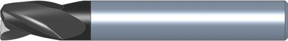

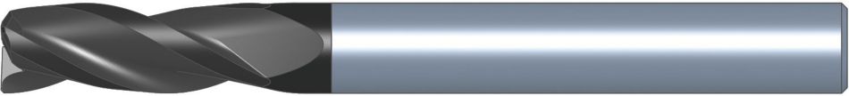

Product Usage
  • Plunge Milling
  • Ramping: Blank
  • Slotting: Square End
  • Side Milling/Shoulder Milling: Square End
  • Helix Angle: 30°
  • Tool Dimensions: Flute Configuration: 3
  • Corner Style: Square End
  • KC633M
    Coated carbide grade with PVD multilayer coating. KC633M is designed for dry milling most types of material, apart from the hardened variety. This grade is characterised by good hardness and wear resistance. It provides outstanding protection for solid carbide tools against cratering and abrasion.
