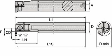

Drawings for 1949657
Material Number1949657
ISO Catalog IDA25RA4EMR0310M
ANSI Catalog IDA25RA4EMR0310M
Insert Size3
[CD] Cutting Depth 10 mm
[CD] Cutting Depth 0.3937 in
[WM] Minimum Groove Width3 mm
[WM] Minimum Groove Width0.1181 in
[D] Adapter / Shank / Bore Diameter25 mm
[D] Adapter / Shank / Bore Diameter0.9843 in
[DM] Minimum Bore Diameter 32 mm
[DM] Minimum Bore Diameter 1.2598 in
[L1] Tool Length 200 mm
[L1] Tool Length 7.874 in
[LH] Head Length 50 mm
[LH] Head Length 1.969 in
[F] F Dimension 17 mm
[F] F Dimension 0.6693 in
[L1S] Secondary Tool Length 198.5 mm
[L1S] Secondary Tool Length 7.815 in
[A] Coolant Hole Diameter 5 mm
[A] Coolant Hole Dia 0.1969 in
Clamp Screw ID Drive SizeT30
