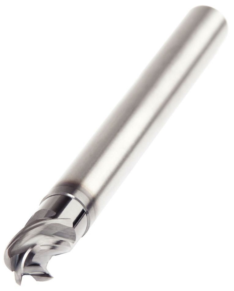

HARVI™ I TE • Ball Nose • 4 Flutes • Necked • Plain Shank • Metric
HARVI™ I TE Four Flute End Mill for Roughing and Finishing Covering the Broadest Range of Applications and Materials

Drawings for 6768007
Material Number6768007
ISO Catalog IDH1TE4BN0300N003HAM
ANSI Catalog IDH1TE4BN0300N003HAM
GradeKCPM15
[D1] Effective Cutting Diameter3 mm
[D1] Effective Cutting Diameter0.1181 in
[D] Adapter / Shank / Bore Diameter4 mm
[D] Adapter / Shank / Bore Diameter0.1575 in
[D3] Neck Diameter 2.82 mm
[D3] Neck Diameter 0.111 in
[AP1MAX] 1st Maximum Cutting Depth3 mm
[AP1MAX] 1st Maximum Cutting Depth0.1181 in
[L3] Usable Length6 mm
[L3] Usable Length0.2362 in
[L] Overall Length 50 mm
[L] Overall Length 1.9685 in
[R] Profile or Ball Nose Radii 1.5 mm
[R] Profile or Ball Nose Radius0.059 in
[Z] Number of Flutes4
  • DrillingDrilling
  • 3D Profiling3D Profiling
  • Side Milling/Shoulder Milling: RoughingSide Milling/Shoulder Milling: Roughing
KCPM15
KCPM15
  • Versatile solid carbide end mill for steels, stainless steel, cast iron, and high temperature alloys.
  • HARVI™ I TE solid carbide end mills cover a variety of operations, including dynamic milling, and extreme ramping operations.
  • HARVI™ I TE solid carbide end mills stand for maximum metal removal, maximum productivity, maximum benefit.
  • HARVI™ I TE solid carbide end mills feature asymmetrical divided flutes, variable helix, twisted end face, faceted eccentric relief, and chip gashes within the flutes.
