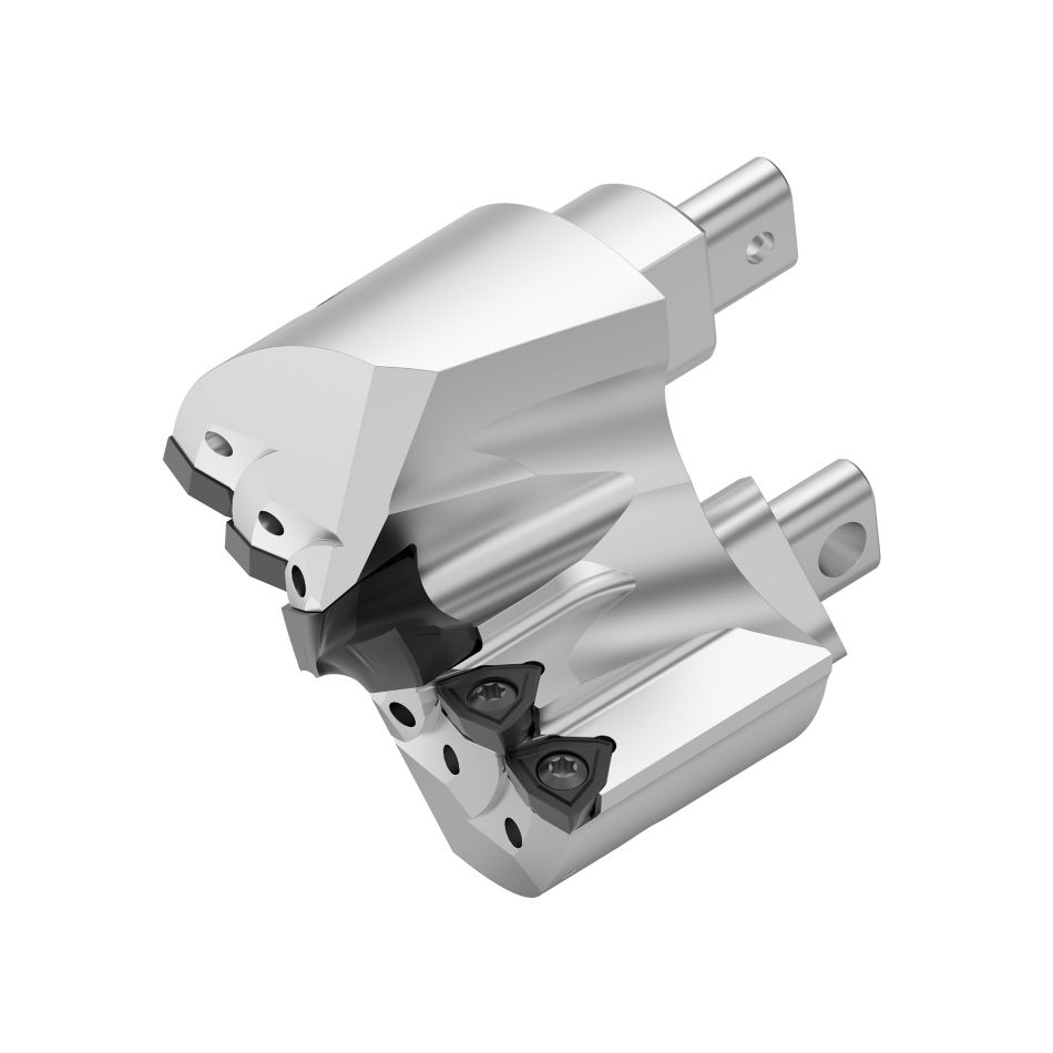

KSEM PLUS™ • A1 Head • Diameter 71.00 - 93.34mm / 2.795 - 3.674″
Modular Drilling • Drill Head with DFT inserts
Material Number5397553
ISO Catalog IDKSEMP8800FDS80A1MANSI Catalog IDKSEMP8800FDS80A1M
- P Steel
- M Stainless Steel
- K Cast Iron
- N Non-Ferrous
- S High-Temp Alloys
- .caption
Drilling - Through Coolant
- Overview
- Application Data
- Downloads
- Spare Parts
| Material Number | 5397553 |
| ISO Catalog ID | KSEMP8800FDS80A1M |
| ANSI Catalog ID | KSEMP8800FDS80A1M |
| [D1] Drill Diameter M | 88 mm |
| [D1] Drill Diameter M | 3.465 in |
| [PDD] Pilot Drill Cut Diameter | 39 mm |
| [PDD] Pilot Drill Cut Diameter | 1.5354 in |
| [LPR] Protruding Length | 54.17 mm |
| [LPR] Protruding Length | 2.133 in |
| [L1] Insert Gage Length | 54.17 mm |
| [L1] Insert Gage Length | 2.133 in |
| [CSMS] System Size Machine Side | FDS80 |
| [SSC] Insert Seat Size | 10 |
- Steel
- Stainless Steel
- Cast Iron
- Non-Ferrous
- High-Temp Alloys
- .caption
- KSEM PLUS™ A1 modular drill head for lowest cost per hole.
- Insert screws and wrenches are included.
- Use four DFT style inserts for this drill head.
- Inserts to be ordered separately.
