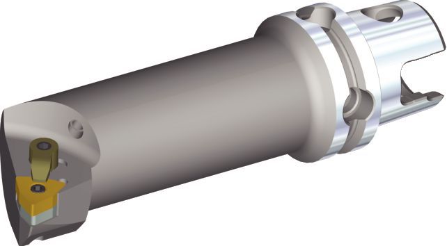

MWLN 95° • KM50TS™
M-Clamping
Material Number3747123
ISO Catalog IDKM50TSS32KMWLNR08ANSI Catalog IDKM50TSS32KMWLNR08
KM40TS™ Internal Cutting Units M-Clamping
$577.08/each
Drawings for 3747123
[DM] Minimum Bore Diameter 40 mm
[DM] Minimum Bore Diameter 1.5748 in
[F] F Dimension 22 mm
[F] F Dimension 0.8661 in
[L4] Maximum Boring Depth 96.26 mm
[L4] Maximum Boring Depth 3.79 in
[L1] Tool Length 125 mm
[L1] Tool Length 4.9213 in
Gage InsertWN..080408/WN..432
Weight Kilograms0.99
Weight Pounds2.17
