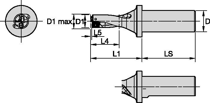

DFR Weldon Shank • DIN 1835-1 Form B • 2 x D
Drill Fix™ DFR™ Bodies
Material Number100056561

WARNING During through-hole operations, a slug or disc is produced as the tool breaks through the workpiece. When the drill is stationary and the workpiece is rotating, this slug may be hurled from the chuck by centrifugal force. Provide adequate shielding to protect bystanders. |
Dimensions • DFR Weldon Shank • DIN 1835-1 Form B
D | LS |
20 | 50 |
