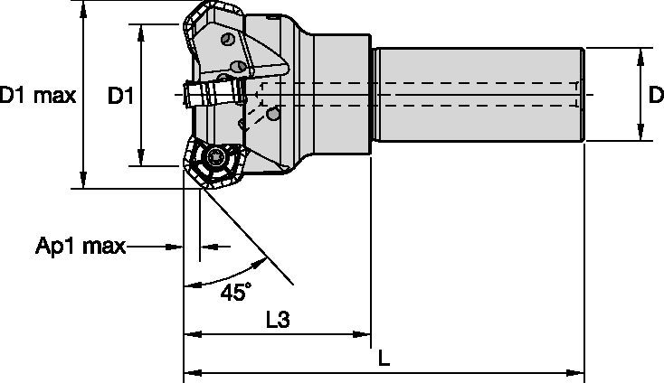

Dodeka™ 45° • End Mill • Cylindrical Shank • Metric
Face milling cutter for multiple materials
Material Number100000599
- Internal coolant supply.
Face Milling
Side Milling/Shoulder Milling: Eased Chamfer
Shank - Cylindrical Plain
Milling - Through Coolant
