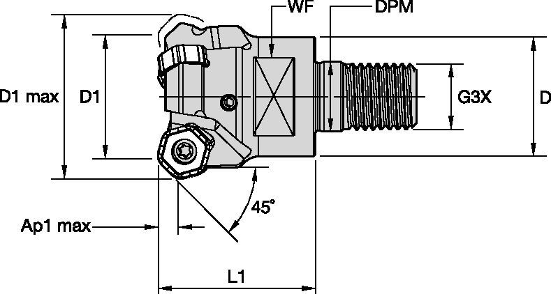

Dodeka™ Mini 45° • End Mill • Screw-On • Inch
Face milling cutter for multiple materials
Material Number100003849
- Internal coolant supply.
Face Milling
Side Milling/Shoulder Milling: Eased Chamfer
Shank - Screw-On
