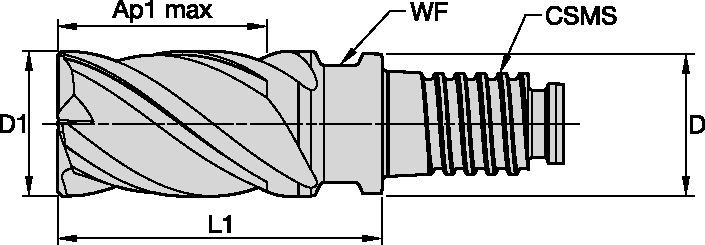

DUO-LOCK™ • HARVI™ I • Square End • 4 Flutes • Inch
HARVI • UKDV • Asymmetrical Flute Spacing
Material Number101923807
- Asymmetrical flute spacing and variable helix configuration minimize chatter and harmonics for smoother machining.
- Center cutting.
- Single tool for both roughing and finishing, reducing setups.
- Standard items listed. Additional styles and coatings made-to-order.
Helix Angle: 37°/39°
Plunge Milling
Ramping: Blank
Slotting: Square End
Tool Dimensions: Flute Configuration: 4
Corner Style: Square End
