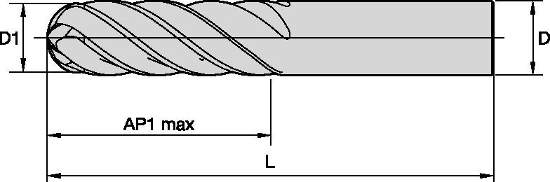

HARVI™ III Aero • Ball Nose • 6 Flutes • Plain Shank • Inch
HARVI™ III Aero Solid Carbide End Mill for High Feed Roughing and Finishing with Maximum Metal Removal Rates
Material Number100100425
- Versatile solid carbide end mill for stainless steel, and high-temperature alloys.
- HARVI™ III Aero solid carbide end mills cover a variety of operations.
- HARVI™ III Aero solid carbide end mills feature unequal flute spacing for chatter-free machining at highest feed rates.
- Eccentric relief grind for higher edge stability and higher feed rates.
- Centre cutting for plunging and ramping operations.
Ball Nose Trochoidal Milling
Side Milling/Shoulder Milling: Ball Nose
3D Profiling
Tool Dimensions: Flute Configuration: 6
Helix Angle: 38°
End Mill Tolerances | |||
D1 | tolerance | D | tolerance h6 + / - |
All | +.000/- .002" | ≤1/8" | +0/-.00024" |
+0/-.00031" | |||
+0/-.00035" | |||
+0/-.00043" | |||
0/.00051" |
