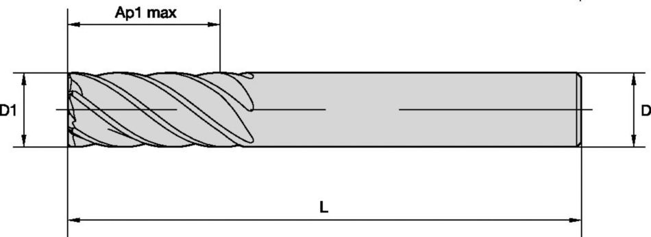

HARVI™ III • Square End • 6 Flutes • Plain Shank • Metric
HARVI™ III Solid Carbide End Mill for High Feed Roughing and Finishing with Maximum Metal Removal Rates
Material Number101242129
- Versatile solid carbide end mill for steels, stainless steel and high-temperature alloys with excellent surfaces
- HARVI™ III solid carbide end mills cover a variety of operations, including dynamic milling
- HARVI™ III solid carbide end mills feature unequal flute spacing for chatter-free machining at highest feed rates
- Eccentric relief grind for higher edge stability and higher feed rates
- Center cutting for plunging and ramping operations
Trochoidal Milling
Ramping: Blank
Tool Dimensions: Flute Configuration: 6
Helix Angle: 38°
Corner Style: Corner Radius
Corner Style: Square End
