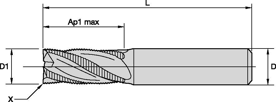

MDRHEC • Rougher
Solid Carbide End Mill for Roughing of Steels, Stainless Steel, Cast Iron
Material Number100003800000
- Center cutting for plunging and ramping operations
- Solid carbide end mill with cord profile, for low cutting forces and low power consumption
Ramping: Blank
Slotting: Square End
Tool Dimensions: Flute Configuration: 4
Helix Angle: 20°
Corner Style: Corner Chamfer
End Mill Tolerances | |||
D1 | d11 | D | tolerance h6 + / - |
1/8" | -.0008/-.0031" | 1/8" | +0/-.00024" |
1/8 - 7/32" | -.0012/-.0041" | 1/8 - 7/32" | +0/-.00031" |
1/4 - 3/8" | -.0016/-.0051" | 1/4 - 3/8" | +0/-.00035" |
13/32 - 11/16" | -.002/-.0063" | 13/32 - 11/16" | +0/-.00043" |
23/32 - 1-3/16" | -.0026/-.0077" | 23/32 - 1-3/16" | +0/-.00051" |
