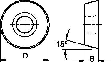

Round Inserts for KDM • RDPX12...-HP
Indexable Round Inserts • RD.X12...
Material Number100000714
- HP geometry is the first choice for steel and high-strength steel at lower cutting forces.
