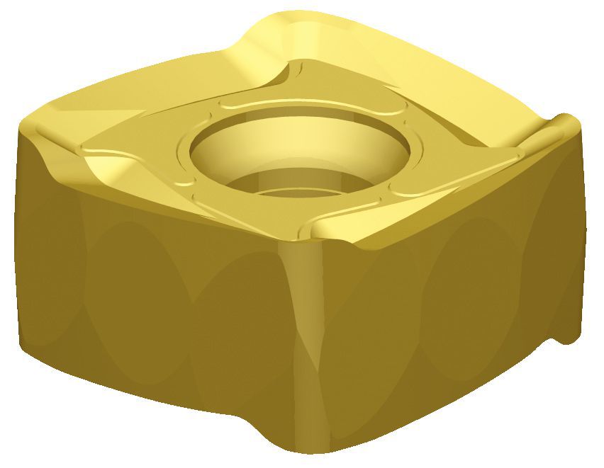

7793 High-Feed • IC 12 • Stellram
The 7793 double-sided insert and high-feed milling cutter system provide cost-effective machining and maximum efficiency for your applications. The face milling system features double-sided inserts with eight cutting edges. The unique geometrical design concept and insert positioning are ideal for achieving metal removal at high rates. The 7793 series provides superior wall and floor surface finish capabilities through roughing operations in comparison with other high-feed solutions. These cutters are particularly qualified to machine unalloyed steels, alloyed steels, tool steels, stainless steels, high-temperature alloys, and titanium when utilizing the GU52 double-sided insert Due to their positive geometry design and reinforced edge, these inserts provide a smooth cutting action and longer tool life in all challenging machining applications.
