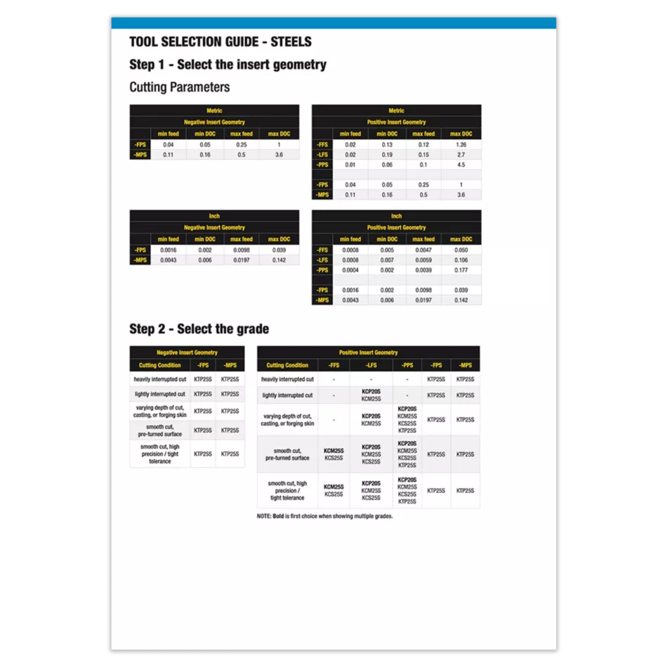

Next Level Turning for Small Parts Machining
TopSwiss small parts machining inserts enhance Kennametal’s turning portfolio with better solutions for aerospace, general engineering, medical and transportation customers facing challenges with achieving superior chip evacuation and surface finish in low feed, high depth-of-cut applications.
TopSwiss Inserts Feature
  • 4 new carbide grades, 1 new cermet grade and 7 new geometries
  • Straight and curved cutting edges for stable cuts and smooth chip flow in low feed, high DOC applications
  • Polished finishing geometries for increased welding resistance and improved surface finishing
  • Medium and finishing wiper geometries for increased feed rates and superior surface quality
  • Several geometries with high chip breaker walls and large pockets for better chip evacuation
TopSwiss Insert Grades
KTP25S PVD:
  • Multilayer coated cermet grade designed specifically for Swiss-type turning
  • Ideal for machining steels and stainless steels with oil or water-soluble coolants
  • Provides excellent fracture and thermal shock resistance
  • Designed for best-in-class tool life at lower speeds and higher depths of cut
  • Wiper geometries for high feed rates while maintaining excellent surface quality
KCM25S PVD:
  • Multilayer coating (AlTiN + AlCrN) applied to cemented carbide for stainless steels
  • Offers superior protection against heat generation and built-up edge
  • Geometries available for fine finishing (FFS), light finishing (LFS) and larger depths of cut parallel positive (PPS)
  • Straight cutting edge (LFS) offers high strength and fracture resistance
  • Highly polished (FFS) improves chip evacuation and provides superior surface quality
KCS25S PVD:
  • Enriched multilayer coating applied to cemented carbide for high-temperature alloys
  • Offers superior chipping and crater resistance
  • Optimum coating and substrate for using controlled vibration (oscillation) turning cycles
  • Geometries available for fine finishing (FFS), light finishing (LFS), and larger depths of cut parallel positive (PPS)
  • Sharp cutting edge (PPS) reduces material adhesion and provides superior surface finish
KCP20S PVD:
  • Multilayer coating (TiCN) applied to cemented carbide for carbon steels
  • Geometries available for light finishing (LFS) and larger depths of cut parallel positive (PPS)
KN10S PVD:
  • Uncoated, fine-grain carbide for non-ferrous materials
  • Precision ground periphery, as well as top and bottom insert faces
  • Nose radii from 0.000” (sharp) up to 0.031”
  • Offers superior protection against edge wear and depth of cut notching
  • Sharp cutting edge, parallel positive (PPS) reduces material adhesion and provides superior surface finish
    • P Steel (204)
        Low-Carbon Steels, Long Chipping C < .25%; <125 HB; <530 N/mm^2 UTS(137)
        Medium and High Carbon Steels C < .25%; <220 HB; <25 HRC; >530 N/mm^2 UTS(137)
        Alloy Steels & Tool Steels C > .25%; <330 HB; <35 HRC; 600-850 N/mm^2 UTS(137)
        Ferritic, Martensitic, and PH Stainless Steels <330 HB; <35 HRC; 600-900 N/mm^2 UTS(204)
        Low-Carbon Steels, Short Chipping C < .25%; <125 HB; <530 N/mm^2 UTS(137)
        High Strength Ferritic, Martensitic, and PH Stainless Steels 350-450 HB; 35-43 HRC; 900-2400 N/mm^2 UTS(204)
        Alloy Steels & Tool Steels C > .25%; 350-420 HB; 35-43 HRC; 850-1400 N/mm^2 UTS(137)
    • M Stainless Steel (183)
        Austenitic Stainless Steel 130-200 HB; <600 N/mm^2 UTS(183)
        Duplex Stainless Steel 135-275 HB; <30 HRC; 500-1200 N/mm^2 UTS(183)
        High Strength Austenitic Stainless and Cast Stainless Steels 150-230 HB; <25 HRC; >600 N/mm^2 UTS(183)
    • N Non-Ferrous Materials (50)
      • N4
        Copper, Brass, Zinc-based on machinability index range of 70-100 (50)
      • N6
        Carbon, Graphite Composites, CFRP (50)
      • N1
        Wrought Aluminum (50)
      • N2
        Low-Silicon Aluminum Alloys and Magnesium Alloys Si <12.2%(50)
      • N3
        High-Silicon Aluminum Alloys Si >12.2%(50)
      • N5
        Nylon, Plastics, Rubbers, Phenolics, Resins, Fiberglass (50)
      • N7
        MMC's (50)
    • S High-Temp Alloys (117)
        Nickel-Based, Heat Resistant Alloys 160-450 HB; <48 HRC; 600-1700 N/mm^2 UTS(117)
        Iron-Based, Heat-Resistant Alloys 160-260 HB; 25-48 HRC; 500-1200 N/mm^2 UTS(117)
        Titanium and Titanium Alloys 300-400 HB; 33-43 HRC; 900-1600 N/mm^2 UTS(82)
        Cobalt-Based, Heat-Resistant Alloys 250-450 HB; 25-48 HRC; 1000-1450 N/mm^2 UTS(117)
