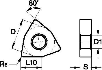

Drawings for 1871319
Material Number1871319
ISO Catalog IDWNGG080402LF
ANSI Catalog IDWNGG4305LF
GradeKC5010
[D] Insert IC Size12.7 mm
[D] Insert IC Size0.5 in
[L10] Insert Cutting Edge Length8.687 mm
[L10] Insert Cutting Edge Length0.342 in
[S] Insert Thickness4.76 mm
[S] Insert Thickness0.1875 in
[Rε] Corner Radius 0.2 mm
[Rε] Corner Radius 0.008 in
[D1] Insert Hole Size 5.16 mm
