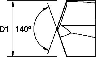

Tool Dimensions: 2flute/2margin/coolant
| Material Number | 3381164 |
| ISO Catalog ID | KSEM2115HPLM |
| ANSI Catalog ID | KSEM2115HPLM |
| Grade | KCMS15 |
| [D1] Drill Diameter | 21.15 mm |
| [D1] Drill Diameter | 0.8327 in |
| [L5] Drill Point Length | 3.36 mm |
| [L5] Drill Point Length | 0.1323 in |
