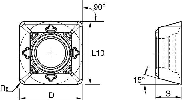

Drawings for 6178252
Material Number6178252
ISO Catalog IDSDHT09T308EN423
ANSI Catalog IDSDHT09T308EN423
GradeKCSM40
[D] Insert IC Size9.525 mm
[D] Insert IC Size0.375 in
[S] Insert Thickness3.97 mm
[S] Insert Thickness0.156 in
[L10] Insert Cutting Edge Length9.525 mm
[L10] Insert Cutting Edge Length0.375 in
[Rε] Corner Radius 0.8 mm
[Rε] Corner Radius 0.031 in
Average Chip Thickness [HM]0.04 mm
Average Chip Thickness [HM]0.0016 in
Cutting Edges per Insert4
