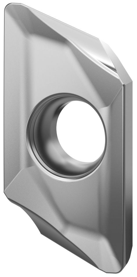

5720 Series • Carbide Insert • ZDET-FR • Light Machining
Shoulder milling insert for high speed aluminum machining with two cutting edges, precision ground.
Material Number5667946
ISO Catalog IDZDET16M504FR721ANSI Catalog IDZDET16M504FR721
ZDET16-FR721 - Stellram - Sharp edge for finishing applications 5667946 - Kennametal
GradeGH1
[LI] Insert Length 23.02 mm
[LI] Insert Length 0.906 in
[W] Insert Width 11.25 mm
[W] Insert Width 0.443 in
[S] Insert Thickness5 mm
[S] Insert Thickness0.197 in
Resultant WorkPiece Radius0.4 mm
Resultant WorkPiece Radius0.02 in
[Rε] Corner Radius 0.4 mm
[Rε] Corner Radius 0.016 in
Average Chip Thickness [HM]0.02 mm
Average Chip Thickness [HM]0.0008 in
Cutting Edges per Insert2
GH1
GH1
Uncoated submicron carbide grade with high wear resistance. GH1 is suitable for machining of aluminum and non-ferrous materials. Also a good choice for the finishing of cast iron. This grade can be used both wet and dry and is designed for light and general machining.
  • Precision ground insert for best surface finish.
