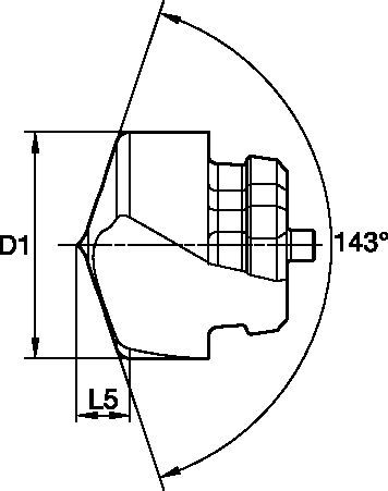

Drawings for 6370946
Material Number6370946
ISO Catalog IDKTFST13492HPCM
ANSI Catalog IDKTFST05312HPC
GradeKC7410
[D1] Drill Diameter 13.492 mm
[D1] Drill Diameter 0.5312 in
[L5] Drill Point Length3.1 mm
[L5] Drill Point Length0.122 in
[SSC] Insert Seat SizeP
  • DrillingDrilling
  • 100160773100160773
  • Tool Dimensions: 2flute/4margin/coolantTool Dimensions: 2flute/4margin/coolant
KC7410
KC7410
Composition: Multilayered PVD AlCrN-based coated fine-grain carbide.
Application: First choice for cast iron. Due to the uniquely developed coating, this grade exhibits extraordinary wear resistance in abrasive materials offering the highest material removal rates.
  • HPC point geometry for highest performance in cast iron.
  • Four margin lands ensure hole straightness.
  • Large corner radius to prevents chipping and reduces exit burs when drilling through holes.
  • Through coolant.
