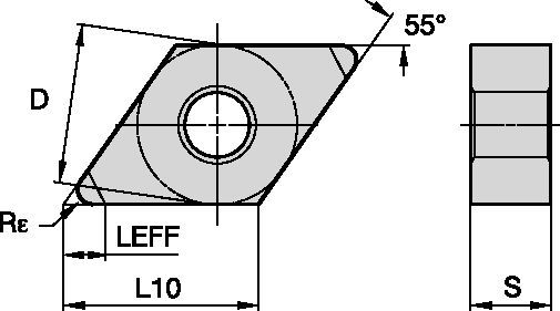

Drawings for 6687559
Material Number6687559
ISO Catalog IDDNGA150608S01225DMT
ANSI Catalog IDDNGA442S0525DMT
GradeKBH20B
[D] Insert IC Size12.7 mm
[D] Insert IC Size0.5 in
[D1] Insert Hole Size 5.16 mm
[D1] Insert Hole Size 0.203 in
[S] Insert Thickness6.37 mm
[S] Insert Thickness0.2508 in
[Rε] Corner Radius 0.8 mm
[Rε] Corner Radius 0.031 in
[Leff] Insert Effective Cut Length2.279 mm
Insert Effect Cut Length [Leff]0.0897 in
