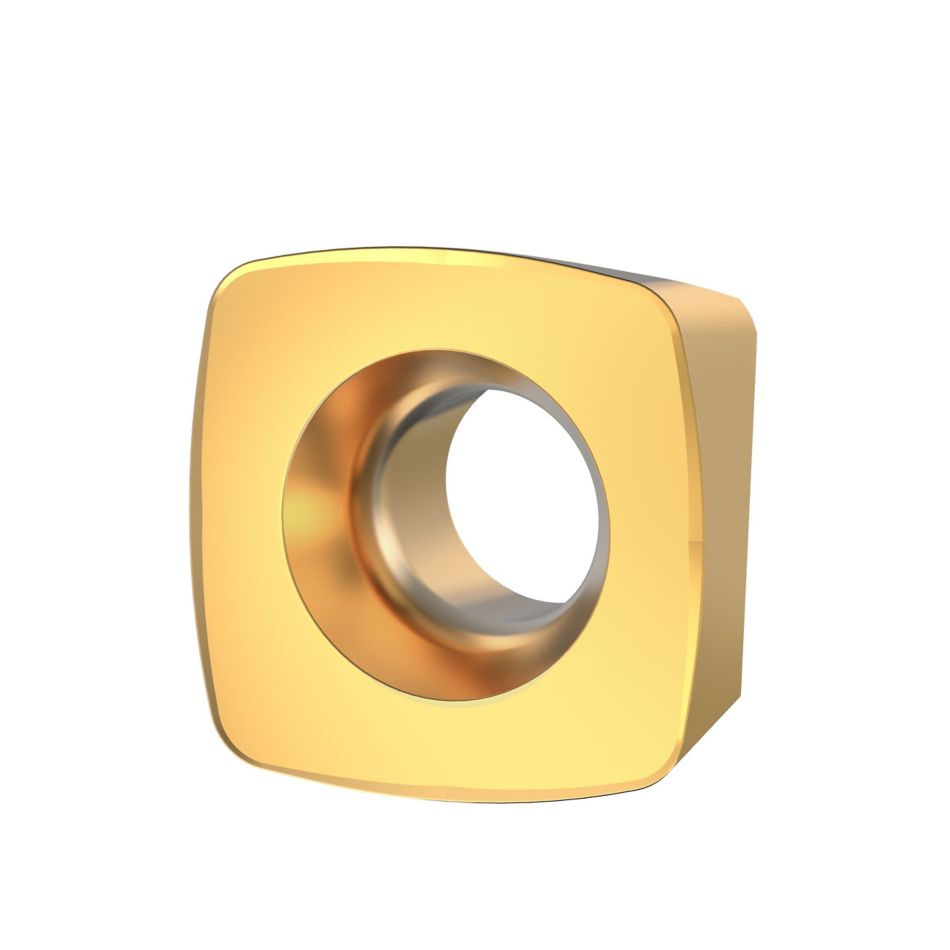

7792VXD09 Series • Carbide Insert • XDLW-D • Heavy Machining
High-feed copy milling insert with four cutting edges, precision ground.
Material Number5651222
ISO Catalog IDXDLW090408SRDANSI Catalog IDXDLW090408SRD
- P Steel
- M Stainless Steel
- S High-Temp Alloys
Material Number | 5651222 |
ISO Catalog ID | XDLW090408SRD |
ANSI Catalog ID | XDLW090408SRD |
Grade | X500 |
[D] Insert IC Size | 9.525 mm |
[D] Insert IC Size | .375 in |
[LI] Insert Length | 9.525 mm |
[LI] Insert Length | .375 in |
[S] Insert Thickness | 4.76 mm |
[S] Insert Thickness | .1874 in |
[Rε] Corner Radius | 0.8 mm |
[Rε] Corner Radius | .0312 in |
Average Chip Thickness [HM] | 0.1 mm |
Average Chip Thickness [HM] | .004 in |
[RT] Theoretical Corner Radius Programing | 2.01 mm |
[RT] Theoretical Corner Radius Programing | .079 in |
- Steel
- Stainless Steel
- High-Temp Alloys
- Precision ground insert for best surface finish
- Single-sided copy milling insert for machining of alloyed steel and cast iron
