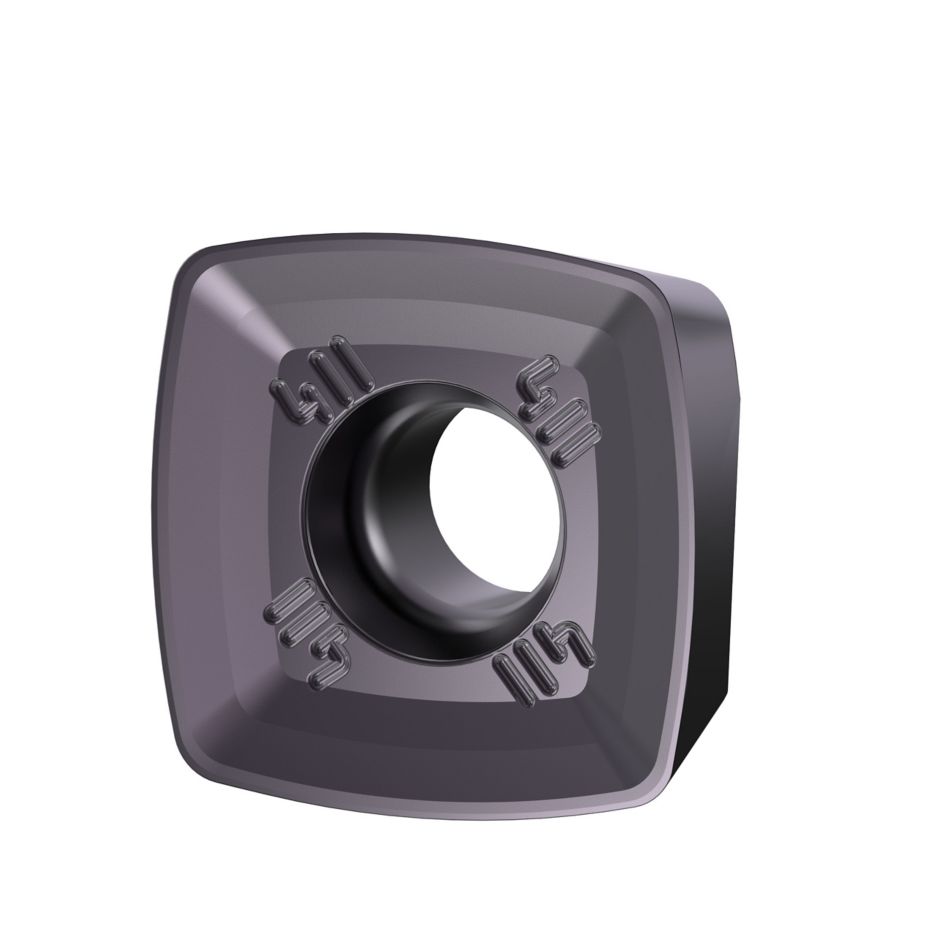

7792VXD12 Series • Carbide Insert • XDLT-D411 • Light Machining
High-feed copy milling insert with four cutting edges, precision ground.
Material Number5652899
ISO Catalog IDXDLT120512ERD411ANSI Catalog IDXDLT120512ERD411
GradeSP6519
[D] Insert IC Size12.7 mm
[D] Insert IC Size.5 in
[LI] Insert Length 12.7 mm
[LI] Insert Length .5 in
[S] Insert Thickness5.563 mm
[S] Insert Thickness.219 in
[Rε] Corner Radius 1.194 mm
[Rε] Corner Radius .047 in
Average Chip Thickness [HM]0.05 mm
Average Chip Thickness [HM].002 in
[RT] Theoretical Corner Radius Programing2.73 mm
[RT] Theoretical Corner Radius Programing.107 in
  • Precision ground insert for best surface finish
  • Single-sided copy milling insert for machining of steels, stainless steel and high-temperature alloys
