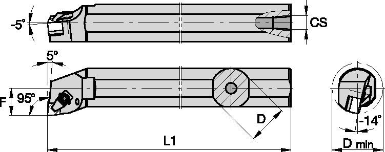

  • I.D. TurningI.D. Turning
Drawings for 1541743
Material Number1541743
ISO Catalog IDA32CCLNL4MX5
ANSI Catalog IDA32CCLNL4MX5
[D] Adapter / Shank / Bore Diameter50.8 mm
[D] Adapter / Shank / Bore Diameter2 in
[DM] Minimum Bore Diameter 59 mm
[DM] Minimum Bore Diameter 2.323 in
[F] F Dimension 32.54 mm
[F] F Dimension 1.281 in
[L1] Tool Length 406.4 mm
[L1] Tool Length 16 in
[CS] Coolant Supply Size1/4-18 NPT
Gage InsertCN.X452
Shim Screw ID Drive SizeT20
Clamp Screw ID Drive SizeT25
