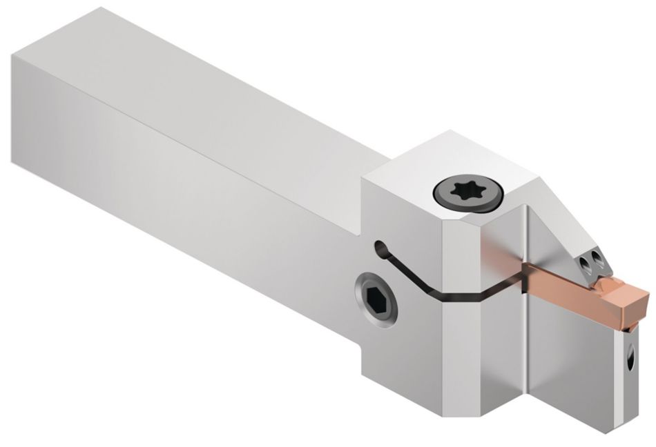

A4 • Integral Toolholder • Through Coolant • Inch
Grooving, and Cut-Off • Square Shank

Material Number | 7061027 |
ISO Catalog ID | A4SMR160417C |
ANSI Catalog ID | A4SMR160417C |
Insert Size | 4 |
[CD] Cutting Depth | 17 mm |
[CD] Cutting Depth | 0.6693 in |
[W] Groove Width | 4 mm |
[W] Groove Width | 0.1575 in |
[H] Shank Height | 25.4 mm |
[H] Shank Height | 1 in |
[H1] Cutting Height | 25.4 mm |
[H1] Cutting Height | 1 in |
[H2] Head Height | 40.7 mm |
[H2] Head Height | 1.6024 in |
[H3]Head Bottom Offset | 5 mm |
[H3]Head Bottom Offset | 0.1959 in |
[B] Shank Width | 25.4 mm |
[B] Shank Width | 1 in |
[L1] Tool Length | 152.4 mm |
[L1] Tool Length | 6 in |
[F] F Dimension | 25.484 mm |
[F] F Dimension | 1.0033 in |
[FS] Secondary F Dimension | 23.484 mm |
[FS] Secondary F Dimension | 0.9246 in |
[LH] Head Length | 39.75 mm |
[LH] Head Length | 1.565 in |
[CS] Coolant Supply Size | G1/8 - 28A |
Clamp Screw ID Drive Size | T30 |
