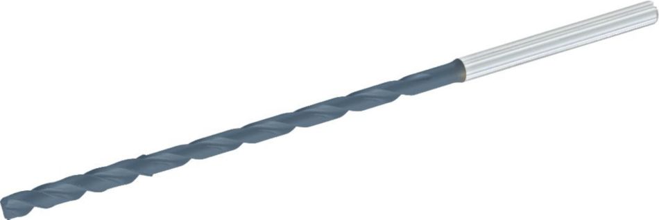

KenDrill™ HPG • 20 x D • Internal Coolant • Straight Shank • Metric
Solid Carbide Deep Hole Drill for Steels and Cast Iron
Material Number5506157
ISO Catalog IDB272Z02400KMGANSI Catalog IDB272Z02400KMG
Drilling: Stacked Plates
Drilling
Drilling: Inclined Exit
Tool Dimensions: 2flute/4margin/coolant
DIN number 6535
Drilling - Through Coolant
Through Coolant: MQL (Minimum Quantity Lubricant): Drilling
Shank - Cylindrical Plain ≤h6
Helix Angle: 30°
Drilling: Cross-Hole Drilling
Material Number | 5506157 |
ISO Catalog ID | B272Z02400KMG |
ANSI Catalog ID | B272Z02400KMG |
Grade | KCPK20 |
[D1] Drill Diameter M | 2.4 mm |
[D1] Drill Diameter M | 0.0945 in |
[L] Overall Length | 101 mm |
[L] Overall Length | 3.9764 in |
[L3] Flute Length | 63 mm |
[L3] Flute Length | 2.4803 in |
[L4] Maximum Drilling Depth | 56 mm |
[L4] Maximum Drilling Depth | 2.2047 in |
[L5] Drill Point Length | 0.479 mm |
[L5] Drill Point Length | 0.0189 in |
[LS] Shank Length | 30 mm |
[LS] Shank Length | 1.1811 in |
[D] Adapter / Shank / Bore Diameter | 3 mm |
[D] Adapter / Shank / Bore Diameter | 0.1181 in |
