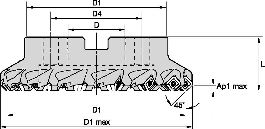

      Beyond BLAST™ KSSM™ 45° • 14mm IC Fine • SE..44... • Inch
      Shell Mills
      SAP Material Number 4137773
      ISO Catalog Number KSSISR250SE443BB45M4
      ANSI Catalog Number KSSISR250SE443BB45M4
      [D1] Effective Cutting Diameter 63.5000 mm
      [D1] Effective Cutting Diameter 2.500 in
      [D1MAX] Maximum Cutting Diameter 77.3100 mm
      [D1MAX] Maximum Cutting Diameter 3.044 in
      [D] Adapter / Shank / Bore Diameter 25.4 mm
      [D] Adapter / Shank / Bore Diameter 1.0 in
      [D6] Hub Diameter 55.5600 mm
      [D6] Hub Diameter 2.188 in
      [L] Overall Length 44.5000 mm
      [L] Overall Length 1.750 in
      [AP1MAX] 1st Maximum Cutting Depth 6.6000 mm
      [AP1MAX] 1st Maximum Cutting Depth .2600 in
      Number of Inserts 5
      Weight Pounds 1.70
      Max RPM 16300
