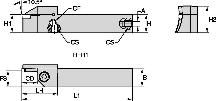

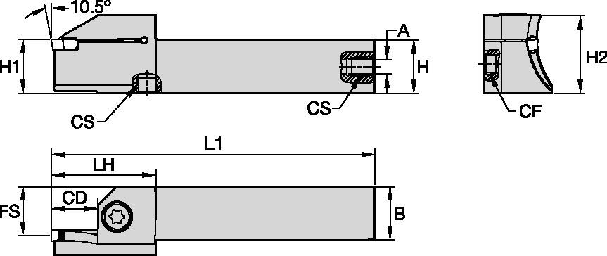

Drawings for 6080477
Material Number6080477
ISO Catalog IDEVSBR160320060075C
ANSI Catalog IDEVSBR160320060075C
Insert Size3
[CD] Cutting Depth 20 mm
[CD] Cutting Depth 0.787 in
[DM] Minimum Bore Diameter 60 mm
[DM] Minimum Bore Diameter 2.362 in
[DMAX] Maximum Bore Diameter75 mm
[DMAX] Maximum Bore Diameter2.953 in
[H1] Cutting Height25.41 mm
[H1] Cutting Height1 in
[B] Shank Width 25.4 mm
[B] Shank Width 1 in
[H2] Head Height 34.95 mm
[H2] Head Height 1.376 in
[L1] Tool Length 152.4 mm
[L1] Tool Length 6 in
[FS] Secondary F Dimension 24.1 mm
[FS] Secondary F Dimension 0.947 in
[LH] Head Length 41 mm
[LH] Head Length 1.614 in
[CS] Coolant Supply Size1/8-27 NPTF
Clamp Screw ID Drive SizeT30

Dimension
Dimensions • Beyond™ Evolution™ Integral Face Grooving Toolholders
