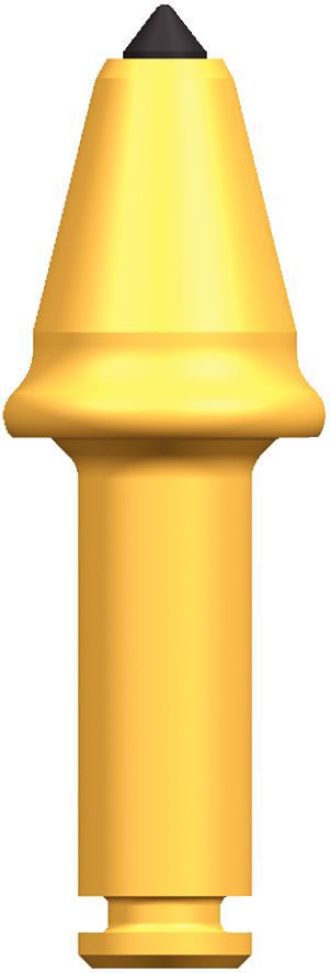

Rotating Tungsten Carbide Pick • 25mm (.99 in) Shank
External Retainer for Maximum Attachment • Plug Tip for Hard Cutting
Material Number1010806
ISO Catalog IDC31RHDANSI Catalog IDC31RHD
    GradeK3560
    Point Included Angle [SIGMA]75
    [TD] Tip Diameter12.217 mm
    [TD] Tip Diameter0.481 in
    [TL] Tip Length20.599 mm
    [TL] Tip Length0.811 in
    [L1] Gage Length62.462 mm
    [L1] Gage Length2.4591 in
    [D2] Body Diameter Workpiece Side46.736 mm
    [D2] Body Diameter Workpiece Side1.84 in
    [D] Shank/Bore Diameter25.146 mm
    [D] Shank/Bore Diameter0.99 in
    [LRO] Retainer Offset Length66.04 mm
    [LRO] Retainer Offset Length2.6 in
    [LS] Shank Length 76.53 mm
    [LS] Shank Length 3.013 in
    [OAL] Overall Length138.992 mm
    [OAL] Overall Length5.4721 in
