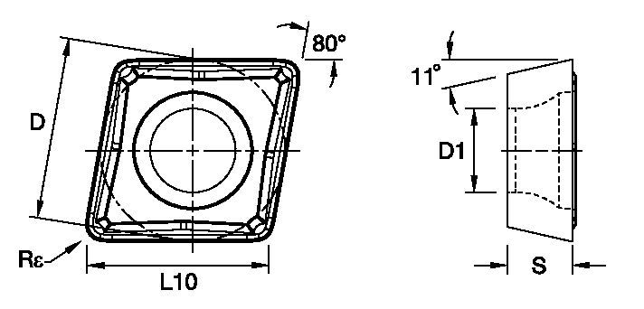

Drawings for 3753931
Material Number3753931
ISO Catalog IDCPMT060204FW
ANSI Catalog IDCPMT2151FW
GradeKCK20
[D] Insert IC Size6.35 mm
[D] Insert IC Size0.25 in
[L10] Insert Cutting Edge Length6.448 mm
[L10] Insert Cutting Edge Length0.2539 in
[S] Insert Thickness2.38 mm
[S] Insert Thickness0.0938 in
[Rε] Corner Radius 0.4 mm
[Rε] Corner Radius 0.016 in
[D1] Insert Hole Size 2.8 mm
[D1] Insert Hole Size 0.1102 in
