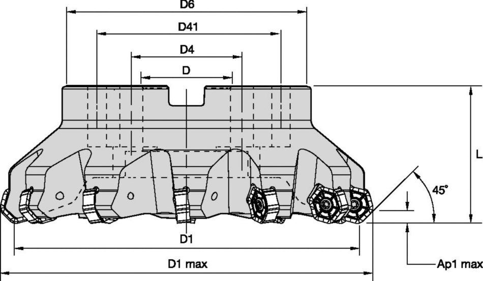

Spare Parts for Dodeka™ 45° • Shell Mill • Metric
Spare Part
INSERT SCR M4-0.7 x 10 T15
Spare Part
SCREW M10-1.5 X 25MM LG SOCKET LOW HD
Spare Part
SHCS W/COOLANT GROOVE
Spare Part
TORX-WRENCH TX15 170.025
