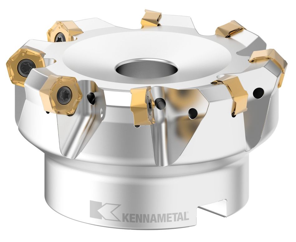

Dodeka™ Mini 45° • Shell Mill • Metric
Face milling cutter for multiple materials
Material Number4122887
ISO Catalog IDKSHR063A04RS45HN06ANSI Catalog IDKSHR063A04RS45HN06
- P Steel
- M Stainless Steel
- K Cast Iron
- N Non-Ferrous
- S High-Temp Alloys
- H Hardened Materials
- Face Milling
- Side Milling/Shoulder Milling: Eased Chamfer
- Milling - Through Coolant
- Milling - Side and Face
- Overview
- Application Data
- Downloads
- Spare Parts
- Reviews
- Q&A
Material Number | 4122887 |
ISO Catalog ID | KSHR063A04RS45HN06 |
ANSI Catalog ID | KSHR063A04RS45HN06 |
[D1] Effective Cutting Diameter | 63 mm |
[D1] Effective Cutting Diameter | 2.48 in |
[D1MAX] Maximum Cutting Diameter | 71.154 mm |
[D1MAX] Maximum Cutting Diameter | 2.801 in |
[D] Adapter / Shank / Bore Diameter | 22 mm |
[D] Adapter / Shank / Bore Diameter | .8661 in |
[D6] Hub Diameter | 50 mm |
[D6] Hub Diameter | 1.969 in |
[L] Overall Length | 40 mm |
[L] Overall Length | 1.575 in |
[AP1MAX] 1st Maximum Cutting Depth | 3.23 mm |
[AP1MAX] 1st Maximum Cutting Depth | .127 in |
Number of Inserts | 4 |
Weight Kilograms | 0.59 |
Max RPM | 10100 |
