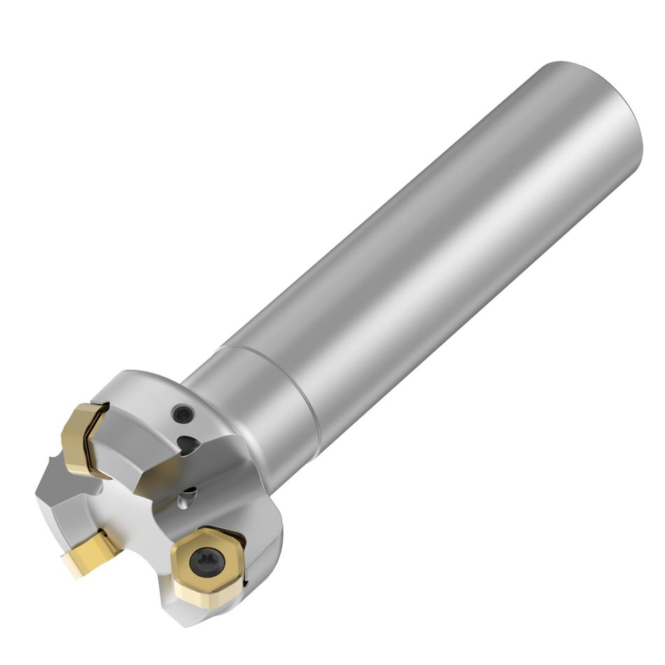

Dodeka™ Mini High-Feed 15° • End Mill • Cylindrical Shank • Metric
Face milling cutter for multiple materials
Material Number4153703
ISO Catalog IDKSHRHF025D03A20HN06L120ANSI Catalog IDKSHRHF025D03A20HN06L120
- P Steel
- M Stainless Steel
- K Cast Iron
- N Non-Ferrous
- S High-Temp Alloys
- H Hardened Materials
- .caption
Face Milling
Shank - Cylindrical Plain
Milling - Through Coolant
- Overview
- Application Data
- Downloads
- Spare Parts
- Reviews
- Q&A
Material Number | 4153703 |
ISO Catalog ID | KSHRHF025D03A20HN06L120 |
ANSI Catalog ID | KSHRHF025D03A20HN06L120 |
[D1] Effective Cutting Diameter | 25 mm |
[D1] Effective Cutting Diameter | 0.984 in |
[D1MAX] Maximum Cutting Diameter | 38.15 mm |
[D1MAX] Maximum Cutting Diameter | 1.502 in |
[D] Adapter / Shank / Bore Diameter | 20 mm |
[D] Adapter / Shank / Bore Diameter | 0.7874 in |
[L] Overall Length | 120 mm |
[L] Overall Length | 4.724 in |
[LBX] Body Length Maximum | 32 mm |
[LBX] Body Length Maximum | 1.26 in |
[AP1MAX] 1st Maximum Cutting Depth | 1.63 mm |
[AP1MAX] 1st Maximum Cutting Depth | 0.064 in |
Number of Inserts | 3 |
Weight Kilograms | 0.31 |
Max RPM | 20000 |
- Steel
- Stainless Steel
- Cast Iron
- Non-Ferrous
- High-Temp Alloys
- Hardened Materials
- .caption
Face Milling
- Internal coolant supply.
