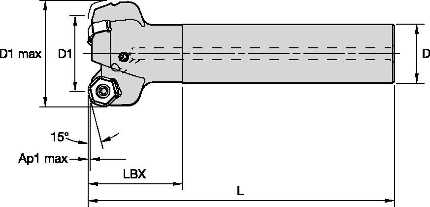

Material Number | 4153704 |
ISO Catalog ID | KSHRHF032D03A25HN06L130 |
ANSI Catalog ID | KSHRHF032D03A25HN06L130 |
[D1] Effective Cutting Diameter | 32 mm |
[D1] Effective Cutting Diameter | 1.26 in |
[D1MAX] Maximum Cutting Diameter | 45.15 mm |
[D1MAX] Maximum Cutting Diameter | 1.778 in |
[D] Adapter / Shank / Bore Diameter | 25 mm |
[D] Adapter / Shank / Bore Diameter | 0.9843 in |
[L] Overall Length | 130 mm |
[L] Overall Length | 5.118 in |
[LBX] Body Length Maximum | 40 mm |
[LBX] Body Length Maximum | 1.575 in |
[AP1MAX] 1st Maximum Cutting Depth | 1.63 mm |
[AP1MAX] 1st Maximum Cutting Depth | 0.064 in |
Number of Inserts | 3 |
Weight Kilograms | 0.52 |
Max RPM | 17600 |
