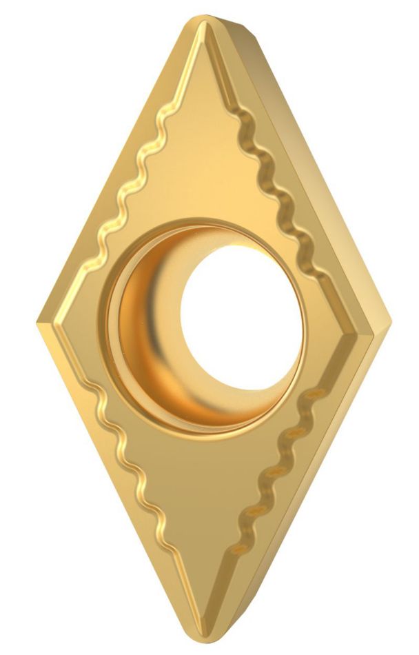

DPMT-UF
Screw-On Inserts
Material Number7093139
ISO Catalog IDDPMT070204UFANSI Catalog IDDPMT2151UF
Screw-On - DPMT Insert - Positive - UF 7093139 - Kennametal
$18.15/each
  • C CFRP Materials
Drawings for 7093139
GradeKCU10B
[D] Insert IC Size6.35 mm
[D] Insert IC Size.25 in
[L10] Insert Cutting Edge Length7.752 mm
[L10] Insert Cutting Edge Length.3052 in
[S] Insert Thickness2.38 mm
[S] Insert Thickness.0938 in
[Rε] Corner Radius 0.4 mm
[Rε] Corner Radius .0156 in
[D1] Insert Hole Size 2.8 mm
[D1] Insert Hole Size .1102 in
  • CFRP Materials
  • Finishing geometry for multiple material groups.
