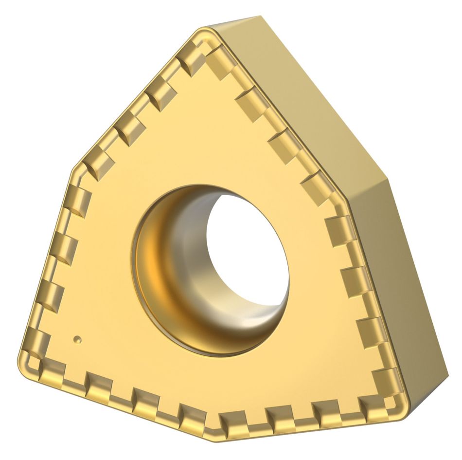

Material Number1157963
ISO Catalog IDDFT030304LDANSI Catalog IDDFT030304LD
DFT-LD Holemaking - 1157963 - Kennametal
$29.00/each
Drawings for 1157963
GradeKC720
[L10] Insert Cutting Edge Length3.97 mm
[L10] Insert Cutting Edge Length0.156 in
[D] Insert IC Size6 mm
[D] Insert IC Size0.236 in
[D1] Insert Hole Size 2.65 mm
[D1] Insert Hole Size 0.104 in
[S] Insert Thickness2.95 mm
[S] Insert Thickness0.116 in
[Rε] Corner Radius 0.4 mm
[Rε] Corner Radius 0.016 in
KC720
KC720
  • TiN-PVD-coated carbide.
  • Particularly high-impact strength grade.
  • For all steels, stainless steels, super-alloys, and titanium.
  • First choice for difficult conditions such as interrupted cutting, unstable clamping, etc.
  • Chipbreaker geometry for difficult applications on steels and stainless steels at low feed rates.
