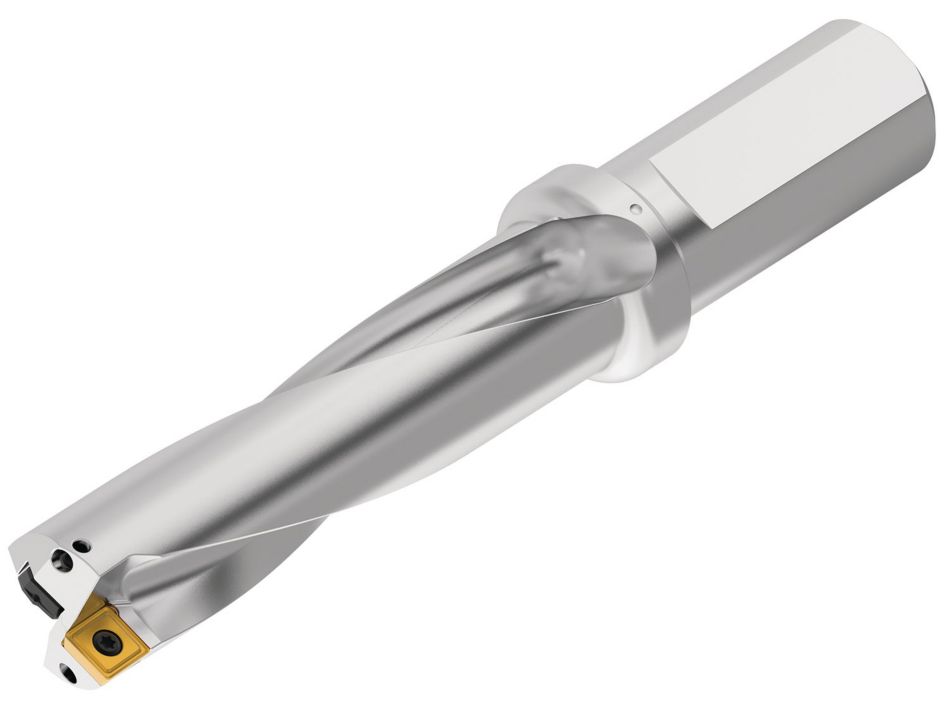

Drill Fix PRO™ • Drill Body • 4 x D • WB Shank • Inch
Indexable Drilling • Weldon® Shank
Material Number7030443
ISO Catalog IDDFPR1250R4WB150ANSI Catalog IDDFPR1250R4WB150

| Material Number | 7030443 |
| ISO Catalog ID | DFPR1250R4WB150 |
| ANSI Catalog ID | DFPR1250R4WB150 |
| [D1] Drill Diameter M | 31.75 mm |
| [D1] Drill Diameter M | 1.25 in |
| [D1MAX] Drill Diameter Maximum | 32.75 mm |
| [D1MAX] Drill Diameter Maximum | 1.2894 in |
| [L5] Drill Point Length | 0.83 mm |
| [L5] Drill Point Length | 0.0327 in |
| [L1] Insert Gage Length | 152 mm |
| [L1] Insert Gage Length | 5.9843 in |
| [L4] Maximum Drilling Depth | 127 mm |
| [L4] Maximum Drilling Depth | 5 in |
| [LS] Shank Length | 70 mm |
| [LS] Shank Length | 2.7559 in |
| [D] Adapter / Shank / Bore Diameter | 38.1 mm |
| [D] Adapter / Shank / Bore Diameter | 1.5 in |
| [CS] Coolant Supply Size | 1/4-18 NPT |
| Internal Face Catalog Gage Insert 1 | DFPR110406__O |
| Internal Face Catalog Gage Insert 2 | DFPR120405__I |

- Versatile indexable drill, covering many workpiece materials.
- For straight hole drilling, inclined entries and exits, interrupted cuts, and rough casted, forged or welded entry surfaces.
- Two eccentric positioned coolant channels for higher coolant volume, providing higher metal removal rates, tool-life, and productivity.
- Helical flutes for perfect chip evacuation.
- Drill body provides high stiffness, eliminating noise and vibrations, resulting in best-in-class hole size accuracy and hole quality.
- The X-offset feature enables diameter adjustment within the machine, and applications on lathe machines.
