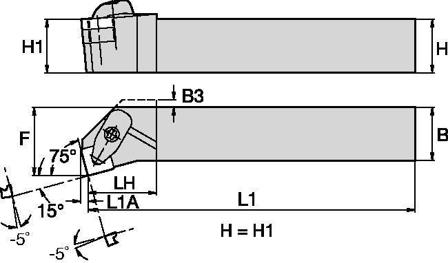

Drawings for 1875220
Material Number1875220
ISO Catalog IDDSKNL2525M12KC04
ANSI Catalog IDDSKNL2525M12KC04
[H] Shank Height 25 mm
[H] Shank Height 0.984 in
[B] Shank Width 25 mm
[B] Shank Width 0.984 in
[F] F Dimension 32 mm
[F] F Dimension 1.26 in
[L1] Tool Length 150 mm
[L1] Tool Length 5.906 in
[LH] Head Length 32 mm
[LH] Head Length 1.26 in
[L1A] L1 A Dimension 3.05 mm
[L1A] L1 A Dimension 0.12 in
[B3] Head Back Offset4 mm
[B3] Head Back Offset0.16 in
Gage InsertSN..120408
Lock Pin ID Drive Size15 IP
Shim Screw ID Drive Size15 IP
Clamp Screw ID Drive Size15 IP
