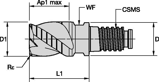

  • Tool Dimensions: Flute Configuration: 3Tool Dimensions: Flute Configuration: 3
  • Helix Angle: 35°Helix Angle: 35°
Drawings for 6441026
Material Number6441026
ISO Catalog IDRFDD0500Y3AQA
ANSI Catalog IDRFDD0500Y3AQA
GradeKCPM15
Adapter Style Machine SideDUO-LOCK
[D] Adapter / Shank / Bore Diameter12.2 mm
[D] Adapter / Shank / Bore Diameter0.4803 in
[L1] Gage Length22.25 mm
[L1] Gage Length0.876 in
[CSMS] System Size Machine SideDL12
[WF] Width of Flat 9.5 mm
[WF] Width of Flat 0.374 in
[Re] Corner Radius 0.375 mm
[Re] Corner Radius 0.015 in
[Z] Number of Flutes3
[D1] Effective Cutting Diameter12.7 mm
[D1] Effective Cutting Diameter0.5 in
[AP1MAX] 1st Maximum Cutting Depth9.525 mm
[AP1MAX] 1st Maximum Cutting Depth0.375 in
KCPM15
KCPM15
  • RFDD Tips — High-performance roughing solution with excellent chip evacuation, especially in stainless steel.
  • The short design and corner radii provide stability and reduce deflection forces.
  • Ideally suited to perform long-reach applications on mill-turn machines, and driven tooling on lathes.
  • The unique cutting geometry results in low cutting forces, requiring low power consumption.
