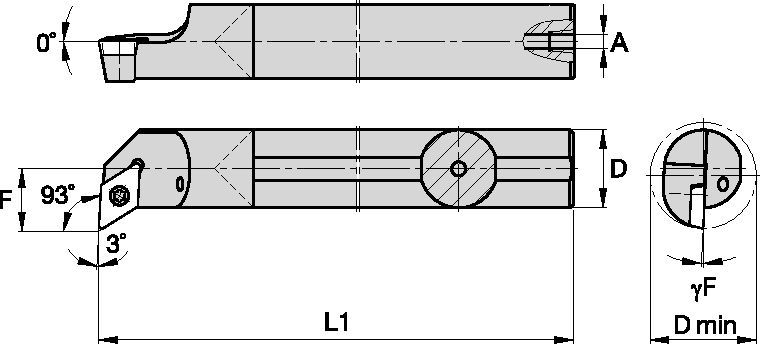

Drawings for 1152741
Material Number1152741
ISO Catalog IDE08RSDUPL2
ANSI Catalog IDE08RSDUPL2
GradeKWH
[D] Adapter / Shank / Bore Diameter12.7 mm
[D] Adapter / Shank / Bore Diameter0.5 in
[DM] Minimum Bore Diameter 18.542 mm
[DM] Minimum Bore Diameter 0.73 in
[F] F Dimension 11.1 mm
[F] F Dimension 0.437 in
[L1] Tool Length 203.2 mm
[L1] Tool Length 8 in
[L] Overall Length 203.2 mm
[L] Overall Length 8 in
[A] Coolant Hole Diameter 4.75 mm
[A] Coolant Hole Dia 0.187 in
[CD] Cutting Depth 4.655 mm
[CD] Cutting Depth 0.1832 in
Gage InsertDP..2151
Insert Screw ID Drive SizeT7
