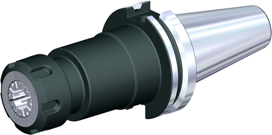

ER™ • CVKV50 Form AD
Material Number6694023
ISO Catalog IDCVKV50ER32600ANSI Catalog IDCVKV50ER32600
ER Collet Adapter CVKV50 Tooling Systems - 6694023 - WIDIA
$542.65/each
  • 100042741100042741
  • ER Solid ColletER Solid Collet
  • Shank - 1"–8 unc DrawbarShank - 1"–8 unc Drawbar
  • Collet - ER DIN 6499Collet - ER DIN 6499
  • Shank - SK CAT(CV) Taper Face ContactShank - SK CAT(CV) Taper Face Contact

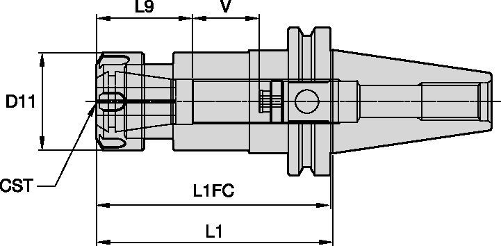

Drawings for 6694023
[CST] Catalog Collet SeriesER32
[D11] Lock Nut Diameter50 mm
[D11] Lock Nut Diameter1.9685 in
[L1] Gage Length152.4 mm
[L1] Gage Length6 in
Gage Length Face Contact [L1FC]150.9 mm
Gage Length Face Contact [L1FC]5.9409 in
[L9] Clamping Length 46 mm
[L9] Clamping Hole Length 1.811 in
[V] Adjustment Range 54 mm
[V] Adjustment Range 2.126 in
Weight Pounds9.31
Stop Screw ID Drive Size4mm & 5/32
