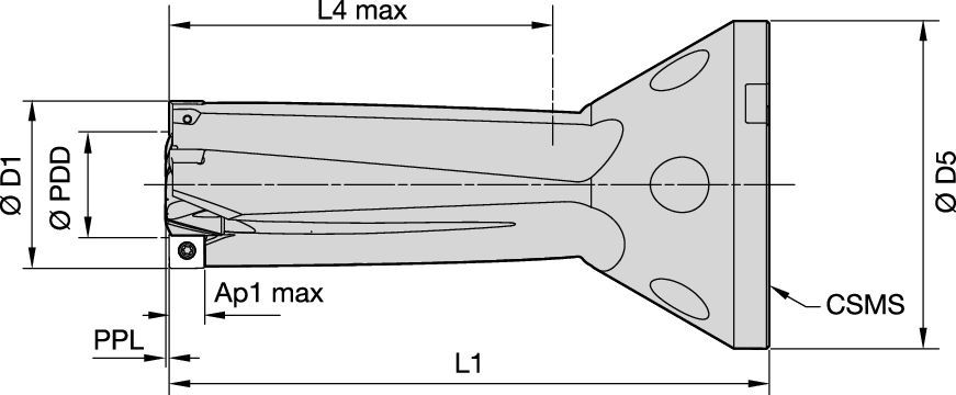

[D1] Drill Diameter M 60 mm
[D1] Drill Diameter M 2.362 in
[PDD] Pilot Drill Cut Diameter38 mm
[PDD] Pilot Drill Cut Diameter1.4977 in
[PPL] Pilot Protrusion Length0.2 mm
[PPL] Pilot Protrusion Length0.0073 in
[L1] Insert Gage Length 215 mm
[L1] Insert Gage Length 8.4616 in
[L4] Maximum Drilling Depth 150 mm
[L4] Maximum Drilling Depth 5.9055 in
[D5] Maximum Body Diameter 117.475 mm
[D5] Maximum Body Diameter 4.625 in
[SSC] Insert Seat Size10
