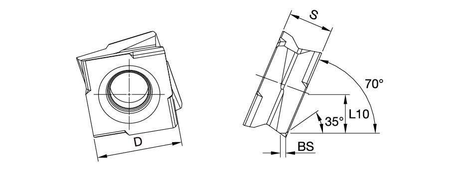

Drawings for 1819853
Material Number1819853
ISO Catalog IDSPHX1205ZCTRGP
ANSI Catalog IDSPHX1205ZCTRGP
GradeKTPK20
[L10] Insert Cutting Edge Length5.41 mm
[L10] Insert Cutting Edge Length0.213 in
[S] Insert Thickness5.5 mm
[S] Insert Thickness0.2165 in
[BS] Corner Facet Length 0.7 mm
[BS] Corner Facet Length 0.0276 in
Average Chip Thickness [HM]0.24 mm
Average Chip Thickness [HM]0.0094 in
Cutting Edges per Insert8
