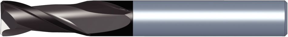

GOmill™ GP • Chamfered • 2 Flutes • Plain Shank • Metric
General Purpose Solid Carbide End Mill
Material Number5872999
ISO Catalog ID2CH0700DD013AANSI Catalog ID2CH0700DD013A

  • DIN number 6528DIN number 6528
  • Tool Dimensions: Flute Configuration: 2Tool Dimensions: Flute Configuration: 2
Drawings for 5872999
GradeKC633M
[D1] Effective Cutting Diameter7 mm
[D1] Effective Cutting Diameter0.2756 in
[D] Adapter / Shank / Bore Diameter7 mm
[D] Adapter / Shank / Bore Diameter0.2756 in
[AP1MAX] 1st Maximum Cutting Depth13 mm
[AP1MAX] 1st Maximum Cutting Depth0.5118 in
[L] Overall Length 60 mm
[L] Overall Length 2.3622 in
[BCH] Corner Chamfer Width 0.1 mm
[BCH] Corner Chamfer Width 0.004 in
[Z] Number of Flutes2

KC633M
KC633M
Coated carbide grade with PVD multilayer coating. KC633M™ is designed for dry milling most types of material, apart from the hardened variety. This grade is characterized by high hardness and wear resistance. It provides outstanding protection for solid carbide tools against cratering and abrasion.
  • Solid carbide end mill with continuous parallel shank according to DIN 6528
  • Solid carbide end mill with excellent cost-benefit ratio
  • Eccentric relief increases cutting edge stability for long tool life and high surface quality
  • Eccentric relief eases regrinding and reduces reconditioning cost
