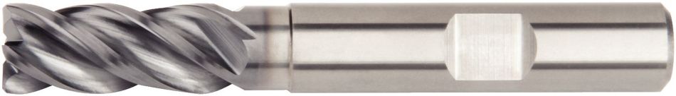

HARVI™ I • Chamfered • 4 Flutes • Necked • Weldon® Shank • Metric
HARVI™ I Solid Carbide End Mill for Roughing and Finishing of Multiple Materials

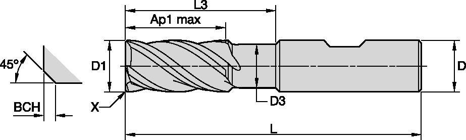

Drawings for 5956378
Material Number5956378
ISO Catalog IDUADE1200B4BV
ANSI Catalog IDUADE1200B4BV
GradeKCPM15
Adapter Style Machine SideWeldon
[D1] Effective Cutting Diameter12 mm
[D1] Effective Cutting Diameter0.4724 in
[D] Adapter / Shank / Bore Diameter0.4724 in
[D3] Neck Diameter 11.28 mm
[D3] Neck Diameter 0.4441 in
[AP1MAX] 1st Maximum Cutting Depth26 mm
[AP1MAX] 1st Maximum Cutting Depth1.0236 in
[L3] Usable Length36 mm
[L3] Usable Length1.4173 in
[L] Overall Length 83 mm
[L] Overall Length 3.2677 in
[BCH] Corner Chamfer Width 0.5 mm
[BCH] Corner Chamfer Width 0.0197 in
[Z] Number of Flutes4

  • Versatile solid carbide end mill for steels, stainless steel, cast iron, and high temperature alloys.
  • HARVI™ I solid carbide end mills cover a variety of operations, including dynamic milling.
  • HARVI™ I solid carbide end mills features unequal flute spacing for chatter-free machining.
