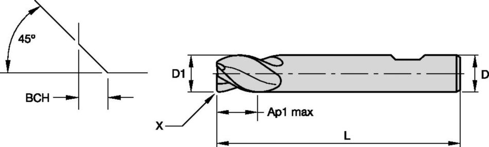

  • Tool Dimensions: Flute Configuration: 4Tool Dimensions: Flute Configuration: 4
Drawings for 4067274
Material Number4067274
ISO Catalog IDHPHV750S4150CH
ANSI Catalog IDHPHV750S4150CH
GradeKCPM15
Adapter Style Machine SideWeldon
[D1] Effective Cutting Diameter19.05 mm
[D1] Effective Cutting Diameter0.75 in
[D] Adapter / Shank / Bore Diameter19.05 mm
[D] Adapter / Shank / Bore Diameter0.75 in
[AP1MAX] 1st Maximum Cutting Depth38.1 mm
[AP1MAX] 1st Maximum Cutting Depth1.5 in
[L3] Usable Length38.1 mm
[L3] Usable Length1.5 in
[L] Overall Length 101.6 mm
[L] Overall Length 4 in
[BCH] Corner Chamfer Width 0.508 mm
[BCH] Corner Chamfer Width 0.02 in
[Z] Number of Flutes4
