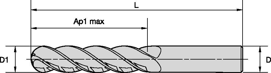

Drawings for 6767751
Material Number6767751
ISO Catalog IDH1TE4BN0438L150HA
ANSI Catalog IDH1TE4BN0438L150HA
GradeKCPM15
[D1] Effective Cutting Diameter11.113 mm
[D1] Effective Cutting Diameter0.4375 in
[D] Adapter / Shank / Bore Diameter11.113 mm
[D] Adapter / Shank / Bore Diameter0.4375 in
[AP1MAX] 1st Maximum Cutting Depth38.1 mm
[AP1MAX] 1st Maximum Cutting Depth1.5 in
[L] Overall Length 101.6 mm
[L] Overall Length 4 in
[R] Profile or Ball Nose Radii 5.55 mm
[R] Profile or Ball Nose Radius0.219 in
[Z] Number of Flutes4

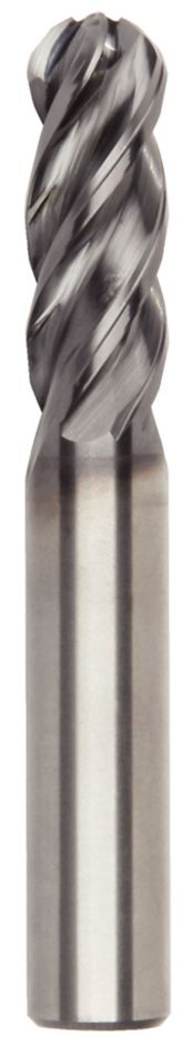

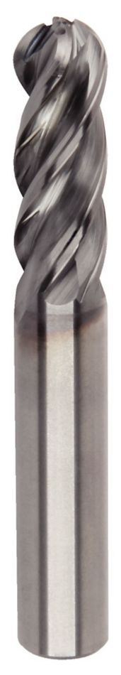

  • Versatile solid carbide end mill for steels, stainless steel, cast iron, and high temperature alloys
  • HARVI™ I TE solid carbide end mills cover a variety of operations, including dynamic milling, and extreme ramping operations
  • HARVI™ I TE solid carbide end mills stand for maximum metal removal, maximum productivity, maximum benefit
  • HARVI™ I TE solid carbide end mills feature asymmetrical divided flutes, variable helix, twisted end face, faceted eccentric relief, and chip gashes within the flutes
  • Long length-of-cut for side milling with excellent wall-to-floor finishing
