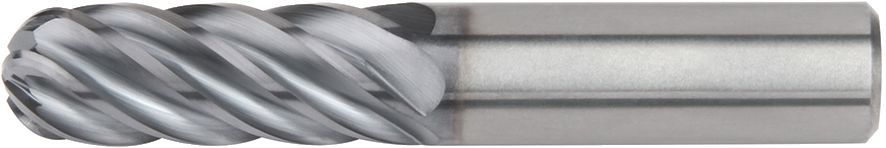

HARVI™ III • Ball Nose • 6 Flutes • Plain Shank • Inch
HARVI™ III Solid Carbide End Mill for 3D Profiling with Highest Productivity
Material Number5607208
ISO Catalog IDUJBE0750J6BANSI Catalog IDUJBE0750J6B
GradeKCSM15
[D1] Effective Cutting Diameter19.05 mm
[D1] Effective Cutting Diameter0.75 in
[D] Adapter / Shank / Bore Diameter19.05 mm
[D] Adapter / Shank / Bore Diameter0.75 in
[AP1MAX] 1st Maximum Cutting Depth38.1 mm
[AP1MAX] 1st Maximum Cutting Depth1.5 in
[L] Overall Length 101.6 mm
[L] Overall Length 4 in
[R] Profile or Ball Nose Radii 9.525 mm
[R] Profile or Ball Nose Radius0.375 in
[Z] Number of Flutes6
  • Ball Nose Trochoidal MillingBall Nose Trochoidal Milling
  • 3D Profiling3D Profiling
  • Tool Dimensions: Flute Configuration: 6Tool Dimensions: Flute Configuration: 6
KCSM15
KCSM15
Coated carbide grade with thick PVD coating and optimized chemistry
and process for increased wear resistance. Outstanding protection in milling stainless steel to mitigate crater, DOCN (depth-of-cut notching), and flank wear. Excellent performance up to 52 HRC.
  • Versatile solid carbide end mill for steels, stainless steel and high-temperature alloys
  • HARVI™ III solid carbide end mills cover a variety of operations
  • HARVI™ III solid carbide end mills feature unequal flute spacing for chatter-free machining at highest feed rates
  • Eccentric relief grind for higher edge stability and higher feed rates
